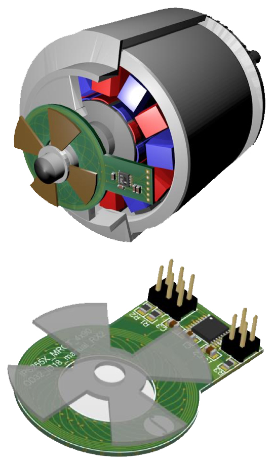

inductive encoders
Rotary inductive encoders use a stator with coils printed onto a circuit board. The rotor can either be made of ferromagnetic material or made of a substrate containing patterns of conductive material such as copper.
Image credit: Renesas
Inductive encoders are similar to LVDTs and resolvers, but instead of using traditional windings, they use flat coils (sometimes referred to as “traces”) manufactured onto printed circuit boards. Rotary inductive encoders contain two main parts — a stator (also referred to as the sensor) and a rotor (also referred to as the target).
The stator contains a transmitter coil and two (or sometimes more) receiver coils, printed onto the circuit board – or in some cases, directly onto the stator substrate. The receiver coils are printed so that they produce sine and cosine waves. In many designs, electronic circuitry for signal processing is also integrated onto the stator. The rotor, or target, is passive and is either made of ferromagnetic material or made of a substrate containing layers, or patterns, of conductive material such as copper.
When voltage is applied to the transmitter coil on the stator, or sensor, an electromagnetic field is produced. As the rotor, or target, passes over the sensor, eddy currents are generated on the surface of the target. These eddy currents generate an opposing field, which reduces the flux density between the sensor and the target, causing a voltage to be generated at the receiver coils on the sensor. The amplitudes and phases of the receiver voltages change as the target moves, and the position of the target can be determined from these voltages.
Inductive encoders are also available in linear versions. Here, the target is a linear scale with ferromagnetic (or electrically conducting) gratings, or stripes. The sensor (also referred to as the read head) contains the transmitter and receiver coils as well as electronics for signal processing. As the read head travels along the scale, the gratings of the scale cause variations in the voltages induced in the receiver coils, and these voltages indicate the sensor’s linear position.
