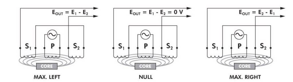

The series-opposed winding of the secondary coils means that when the core is at the center of the transformer (equidistant between the two secondary coils), the induced voltages have equal amplitude but are out of phase by 180 degrees. Thus, the induced voltages cancel each other, and the output voltage is zero. (This is often referred to as the null point.)
When the core moves to one side — toward S1 for example — the secondary coil on that side becomes more strongly coupled to the core, causing the induced voltage (E1) of that secondary to be higher than the induced voltage (E2) of the opposite secondary (S2). The differential voltage output (E1 – E2) determines the amount of movement.
LVDT
The amplitude of the differential output voltage determines the distance traveled, and the phase of the output voltage indicates the direction traveled.
Image credit: TE Connectivity
The induced voltage (E1) of the first secondary coil is in-phase with the primary voltage, indicating the direction of movement. Conversely, when the core moves to the other side of the transformer, the induced voltage (E2) of that secondary coil is out of phase with the primary voltage, indicating movement in the opposite direction.

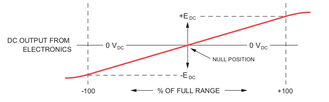

The output of an LVDT is a direct and linear function of the input across its specified measuring range, although linearity falls off as the core reaches or exceeds the ends of its range. However, it is possible to use an LVDT beyond its specified range, in some cases, with a pre-defined table or polynomial function to compensate for the nonlinearity.
LVDT
LVDT output is a direct, linear function of the input voltage up to the device’s specified measuring range. Beyond this point, linearity begins to fall off.
