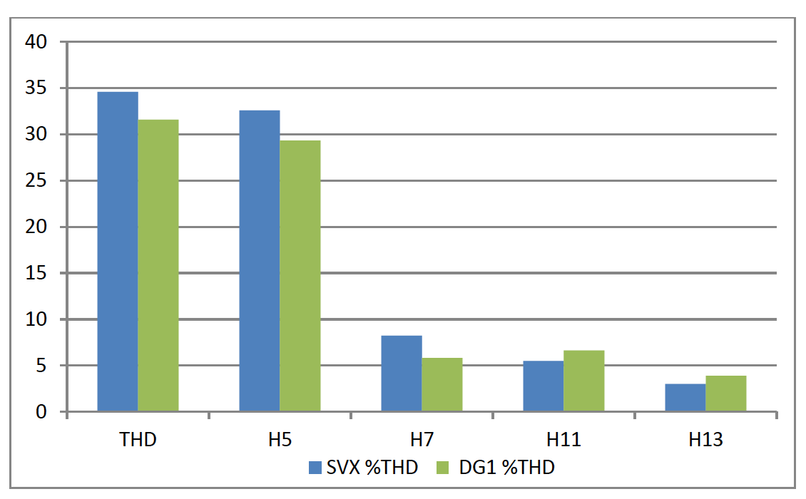

As an impedance device on the input side of a variable frequency drive, a DC bus choke behaves much the same as an AC line reactor, but with several additional benefits and one main drawback.
Like an AC line reactor, a DC bus choke limits the peak value of the line (supply) current, which mitigates harmonics transmitted from the line — especially the 5th and 7th harmonics. This is important because the 5th and 7th harmonics are the main contributors to total current harmonic distortion, and DC bus chokes do a better job of attenuating these harmonics than AC line reactors do. And DC bus chokes add the necessary impedance to reduce harmonics without causing the noticeable drop in voltage on the DC bus that AC line reactors typically cause. (Lowering the voltage on the DC bus limits the maximum voltage available to operate the motor, which can increase motor current and cause the motor to slip.)
DC bus choke
The DC bus choke (green) reduces the 5th and 7th harmonics (H5 and H7) better than the AC line reactor (blue) and provides better total harmonic distortion (THD).
Image credit: Eaton Corporation
