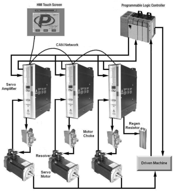

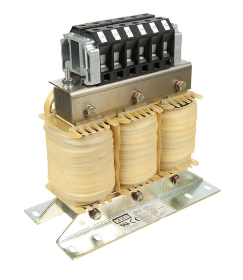

A motor choke is the common name given to an inductive device installed between the output of a servo drive or variable frequency drive (VFD) and the terminals of the servo motor or AC induction motor. Its purpose is to reduce the current peaks that occur at the drive output due to pulse-width modulation (PWM) of the voltage.

A motor choke is an inductive device placed between the drive and the motor and is often recommended when the motor cable length exceeds 25 meters.

However, PWM control causes sharp changes of the drive signals, as well as noise due to the high-frequency switching — problems that are exacerbated when long cables are used between the drive and the motor. Like the motor coils, cables also posses impedance, and if the impedance of the cable is vastly different than the motor impedance, a reflected wave can occur, sending voltage back through the cable from the motor terminals to the drive. This voltage can, in a worst-case scenario, add to the voltage supplied by the drive and result in very high voltage at the motor, causing significant motor heating and damage to the motor insulation and bearings.
A motor choke helps to remedy these problems by extending the rise time (dV/dt) of the drive signals. This reduces the sharp corners, or peaks, of the voltage waveform to rounded edges, protecting the motor from surges and the associated heating that occurs. A choke placed between the drive and the motor also helps to reduce electromagnetic interference from the cables and the possibility of reflected waves.
Without a motor choke, drive manufacturers typically recommend a maximum motor cable length of around 25 meters (recommendations vary depending on the motor, drive, and application). With a motor choke, the maximum cable length can be significantly extended, often to 50 or 100 meters.
