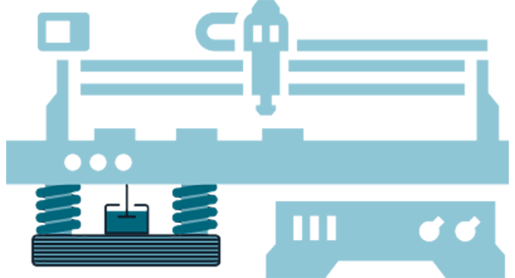

tuned mass damper
A tuned mass damper includes a moving mass, spring element, and damper to counter the motion and energy caused by vibrations.
Image credit: MAQ AB
A tuned mass damper (TMD) is a relatively simple and efficient vibration-reduction device, consisting of a mass, stiffness elements (springs), and a damper. The types of dampers used in TMD devices include pneumatic or hydraulic dashpots, viscoelastic materials, and magnetic dampers (also referred to as eddy current dampers). As the machine or structure vibrates, the tuned mass damper vibrates at the same frequency but out of phase with the machine. The inertial force of the TMD reduces the vibrational energy transmitted to the machine and dissipates that energy as heat.
The system is referred to as “tuned” because the mass and springs are tuned, or adjusted, to the structural mode (i.e. the natural frequency) of the machine or structure to be damped. This is typically the first vibrational mode (first natural frequency), since it plays the most significant role in a system’s dynamic response.

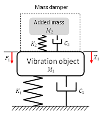

tuned mass damper
Active tuned mass dampers sense machine vibrations and use actuators to induce counteracting forces specific to the current vibration modes.
Image credit: Vicoda
The effectiveness of a tuned mass damper at reducing vibrations depends on three factors:
  • Mass ratio: ratio of the TMD mass to the structure or machine mass
  • Frequency ratio: ratio of the frequency of the TMD to the natural frequency of the structure or machine (ideal frequency ratio = 1)
  • Damping coefficient of TMD: how well the TMD dissipates energy (lower coefficient means better damping)
Although there are practical limits to the mass used in a tuned mass damper, a TMD device with even a small mass (relative to the mass being damped) can achieve significant vibration reduction.
