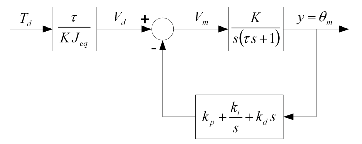

To address unexpected forces that cause the motor to move away from the target value, the controller uses a function known as disturbance rejection, which processes the disturbance and provides commands that correct for these unknown forces or conditions.
Block diagram for a PID controller with an input disturbance (Td).
Image credit: Quanser Inc.
In control tuning, the proportional gain (kp) determines the amount of disturbance rejection. This makes sense because the proportional gain issues an error correction signal that is directly proportional to the error. So when a disturbance occurs, causing the motor to deviate from the desired state, the proportional gain outputs a correction signal to bring the motor back toward the desired state. In theory, the higher the proportional gain, the better the disturbance rejection. But in real-world applications, the maximum value of proportional gain that can be used without causing instability is limited by the system bandwidth and phase margin.
