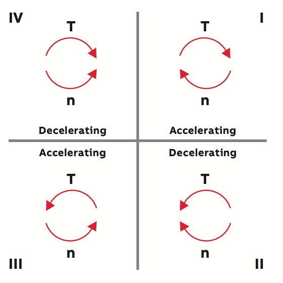

In quadrants II and IV, the direction of motor rotation (n) opposes the direction of torque (T), meaning the motor is braking.
Image credit: ABB

To implement flux braking, the AC drive (variable frequency drive, or VFD), must use direct torque control (DTC), which is a control scheme that decouples the flux-producing current and the torque-producing current to the motor and controls them independently. Flux braking takes advantage of DTC’s separation of flux-producing and torque-producing current to control motor braking.

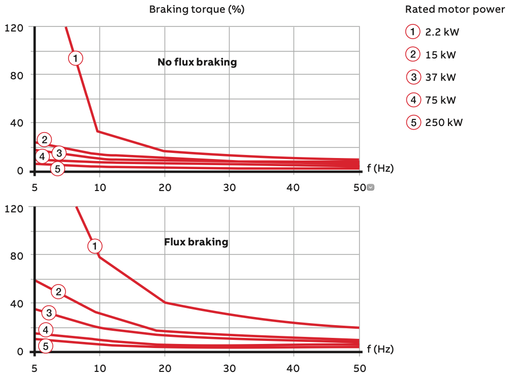

When the motor is acting as a generator — during stopping or overrunning — flux braking increases the flux-producing current in the motor. Instead of sending the extra energy to external resistors, as other methods do, flux braking essentially uses the motor as the braking resistors. By increasing the magnetic flux (and, therefore, current) in the motor, the load can be quickly decelerated while the motor speed and rate of stopping remains controlled.
With flux braking, heat inside the motor is increased, so this method is best for applications that only require occasional braking operation. If the application requires continuous braking or experiences frequent overhauling, other braking methods, such as regenerative braking, may be a better choice.
flux braking
The percentage of motor braking torque to rated torque as a function of output frequency. Notice that flux braking provides the most benefit for smaller motors.
Image credit: ABB
