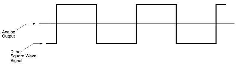

dither
A square-wave dither signal is added to the analog output of the servo controller. This dither causes the system to oscillate very slightly, avoiding the effects of stick-slip.
Image credit: Parker

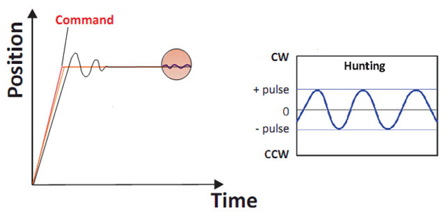

It’s important to note that the terms “hunting” and “dithering” are sometimes used interchangeably. However, hunting is an undesirable result of a servo system attempting to correct an error between the commanded position and the actual position.
Hunting can be exacerbated by the controller’s gain settings — particularly the integral gain, which increases over time to force the system to zero positioning error at the end of the move. However, the error is constantly varying, so the system must react rapidly to implement corrective moves before the position changes again. But any lag between the detection of the position error and the corrective move can cause the system to overshoot the target position, causing an error in the opposite direction. Now the system must initiate a corrective move in the reverse direction, but overshoots again due to the integral gain. This cycle of oscillation around the desired position is referred to as hunting.
A technical definition of hunting, in the context of motion control, is periodic oscillation of the axis about the target position.
Image credit: American Motion Technology
