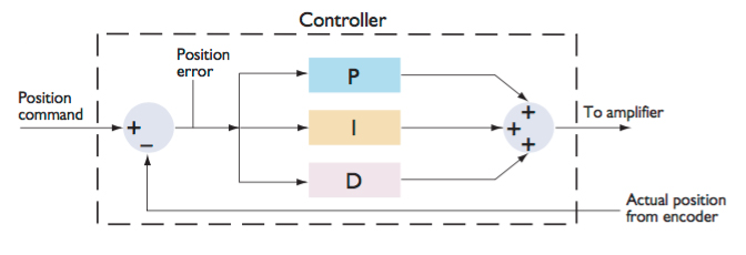

One way to reduce hunting is through proper tuning. Tuning is done by adjusting proportional (P), integral (I), and derivative (D) gains. Each gain plays a role in the system’s tendency to overshoot and cause hunting, and while servo tuning is as much art as it is science, understanding the gains and their effects on system behavior (and their interdependencies) can help prevent or reduce hunting.
hunting
The levels of the proportional (P), integral (I), and derivative (D) gains play a significant role in an axis’ tendency to overshoot, oscillate, and hunt for position.
Image credit: PMD Corp.
In general, a high proportional gain (Kp) can cause overshoot and oscillation, or hunting, for the target point, while the derivative gain (Kd) helps to dampen the system, reducing overshoot and oscillatory motion. A high integral gain (Ki) can also cause overshoot and hunting because it is determined by the sum of errors over time and increases at the end of the move.
