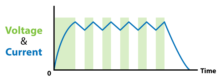

Because constant voltage drives deliver limited torque at higher speeds, many stepper motor applications use chopper drives. Chopper drives are also referred to as “constant current” drives because they monitor and regulate the current to the motor, rather than the voltage. The term “chopper drive” comes from the fact that the drive rapidly switches the voltage on-and-off (referred to as “chopping” the voltage) to control the amount of current delivered to the motor.
chopper drive voltage and current
Relationship between voltage (green) and current (blue) when a stepper motor is driven with a chopper drive.
Image credit: Clippard

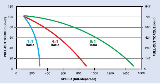

To ensure the stepper motor receives enough current to produce the rated torque, regardless of motor speed, a very high voltage, or overvoltage, is provided by the chopper drive. This high voltage ensures a fast current rise, so even if the motor is operating at high speeds, it receives a constant RMS (root mean square) value of current to produce the required torque.
stepper motor overvoltage
The higher the ratio of the supply voltage to the motor’s rated voltage, the more the torque speed curve is “pushed out.”

But why is it ok to drive a stepper motor with overvoltage when using a chopper drive? Because a chopper drive places a resistor in series with each motor winding to monitor the motor current.
When the voltage across the resistor reaches a predefined high level, which represent’s the motor’s rated current (I = V/R), the voltage supply is switched off. And when the voltage across the resistor drops below a preset level, the voltage supply is switched on again. Pulse-width modulation (PWM) is used to vary the width of the output pulses from the drive, according to how much voltage “on” time is needed.
The result is that torque can be controlled more precisely, and more torque can be produced at higher speeds, without the heating problems that would occur if overvoltage was applied with a simple L/R, or constant voltage, drive.
