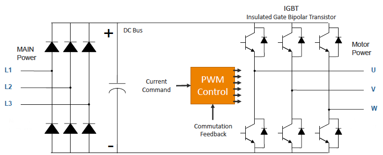

PWM drive schematic
A PWM drive switches the transistors in the inverter section on-and-off to provide a simulated sine wave voltage to the motor.
Image credit: M. Pelletier, Yaskawa
PWM drives switch the transistors on-and-off at a very high frequency — typically 10 to 20 Hz — creating a train of square-wave pulses that simulates an analog, sine wave signal.

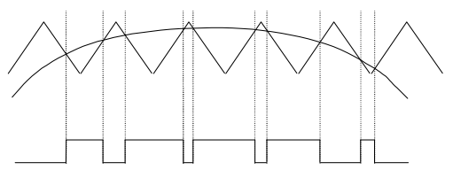

The pulses for a PWM drive can be created in one of two ways. In the traditional method, often referred to as carrier-based PWM, the PWM pulses are created using the triangular signal that represents the switching frequency of the inverter, together with a sine wave signal produced by the PWM generator.
PWM generator signals
With carrier-based PWM, the modulated PWM pulses (bottom) are created from the triangular signal that is the switching frequency of the inverter and the sine wave signal produced by the PWM generator.
Image credit: Rockwell Automation
