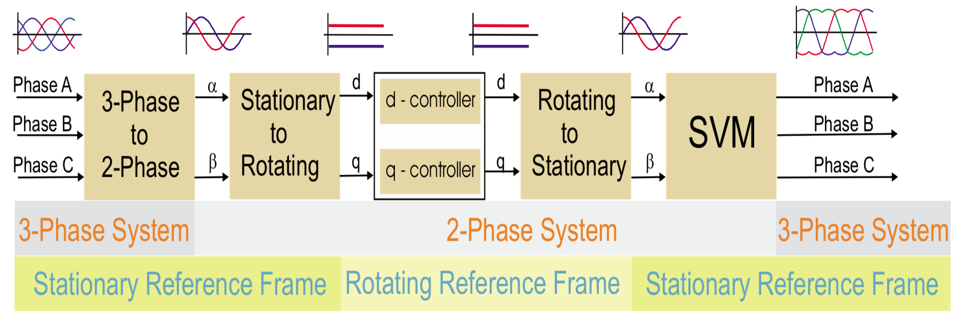

SVPWM
Field oriented control transforms a three-phase system time-dependent system into a two-coordinate (d and q), time-invariant system. SVPWM is used in the final step to determine the PWM signals to be applied to the motor.
Image credit: Freescale Semiconductor

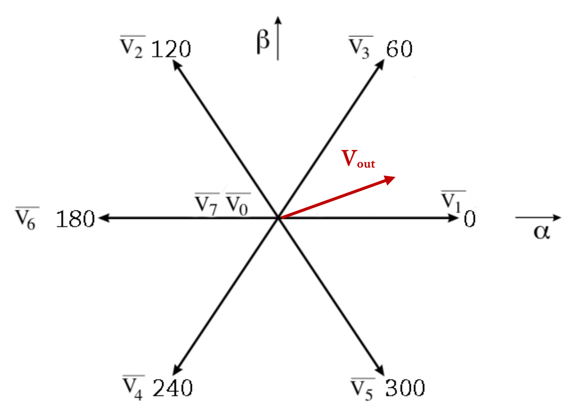

The eight base vectors are plotted on a hexagonal star diagram. Each vector makes up a spoke of the star, with 60 degrees phase difference between adjacent vectors. The two vectors (V0 and V7) that contain outputs which are either all plus or all minus are referred to as null vectors and are plotted at the center (origin) of the star.
SVPWM
Each base vector makes up one segment of a hexagonal star, with the null vectors (V0 and V7) plotted in the center.

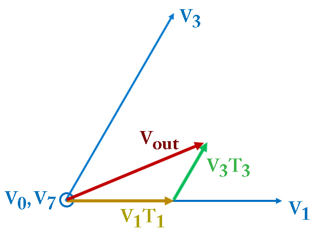

The goal of SVPWM is to produce a “mean vector” during the PWM period (TPWM) that is equal to the desired voltage vector (Vout).
SVPWMThe location of Vout is determined on the star diagram, and the base vectors that constrain that sector (V1 and V3, for example), along with one of the null vectors, are used to synthesize the desired voltage. This is done by applying V1 for a specified time (T1), V3 for a specified time (T3), and the null vector for the amount of time necessary (T0) to provide a resultant vector equal to Vout.
The values of T1, T3, and T0 can be determined with the following equations:
SVPWM
SVPWM
SVPWM
