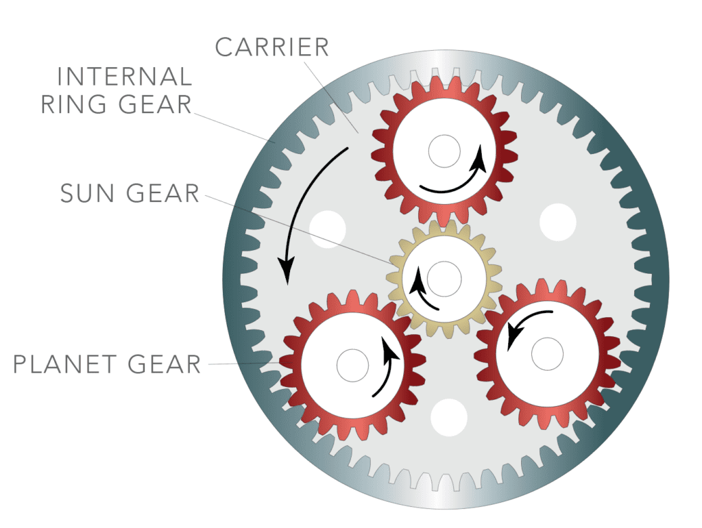

Updated 2020 ⚙️ Gearboxes provide torque multiplication, speed reduction, and inertia matching for motor-driven systems. Servo systems, specifically, require gearboxes that can supply not only high torque with low added inertia, but also high precision and stiffness. One type of gearbox meets all these criteria while providing relatively long operating life with low maintenance requirements — the planetary gearbox.
A planetary gearbox consists of multiple planetary gears that revolve around a central sun gear while engaging with an internal gear and rotating on their own axes. The continuous engagement of the planetary gears means the load is shared by multiple teeth, allowing planetary designs to transmit high torque loads.
This load sharing among teeth also gives planetary gearboxes high torsional stiffness, making them ideal for processes that involve frequent start-stop motions or changes in rotational direction, which are common characteristics of servo applications. Most servo applications also require very precise positioning, and planetary gearboxes are designed and manufactured to have low backlash, with as little as 1-2 arcmin in some cases.
Note: Planetary gearboxes can use spur or helical gears. While spur gears can have higher torque ratings than helical gears, helical designs have smoother operation, less noise, and higher stiffness, making helical planetary gearboxes the preferred gearbox for servo applications.
