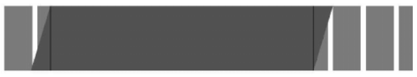

Another approach uses destructive interference to cancel out the cogging forces. In this method, the primary contains more lamination teeth than there are magnets on the secondary (magnet track) – a winding method known as fractional winding. This imbalance between the number of teeth in the primary and magnets on the secondary allows the cogging forces caused by the inner teeth to cancel out.
The cogging force created by the outer teeth is addressed by adding a triangle to each end of the lamination stack, changing its shape from a rectangle to a parallelogram. These triangles on the ends of the lamination stack are shifted by 180 degrees in the magnetic cycle and create cogging forces equal but opposite to those created by the the outer teeth of the lamination stack. This, in combination with the fractional winding, virtually eliminates force ripple.

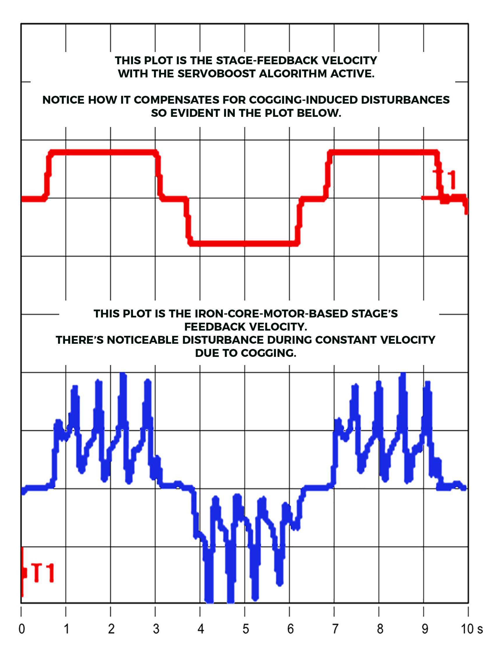

In addition to hardware solutions, which involve added cost and manufacturing complexity, cogging can also be addressed in the servo control system. Specifically, a feed-forward signal to the current command will smooth the motor’s force production and torque ripple. And keep in mind that torque ripple also causes velocity ripple, so a high-bandwidth velocity control loop, together with feed-forward commands, can help to smooth velocity for applications that are highly sensitive to speed fluctuations.
