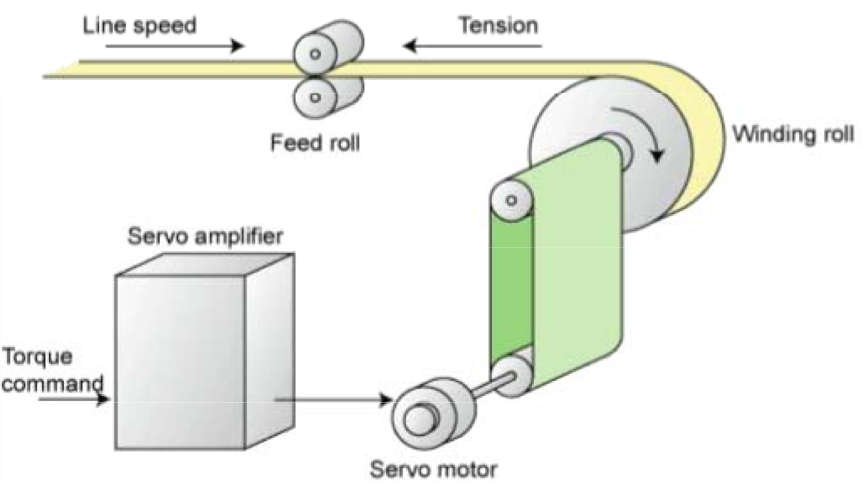

In torque mode (also referred to as current mode), the current loop controls the motor’s behavior. Since torque is directly proportional to current, the servo controller obtains the actual motor current from the servo drive and uses this to determine actual motor torque. It then compares the actual torque value with the desired torque and adjusts the current delivered to the motor to achieve the desired torque. The current control loop is typically tuned with a PI (proportional-integral) controller, and current loop parameters are often set by the manufacturer.
Applications that require torque mode control range from winding, where constant tension must be held on a web of material while it’s wound, to injection molding, where constant clamping force must be applied to the mold.
torque mode
In winding applications, the torque required from the motor varies as the material is wound and the diameter (load and inertia) of the roll increases.
Image credit: Mitsubishi Electric
The amount of torque a motor produces depends on the amount of current it receives. And torque determines the motor’s acceleration, which affects velocity and position. Thus, servo systems always include a current control loop.
