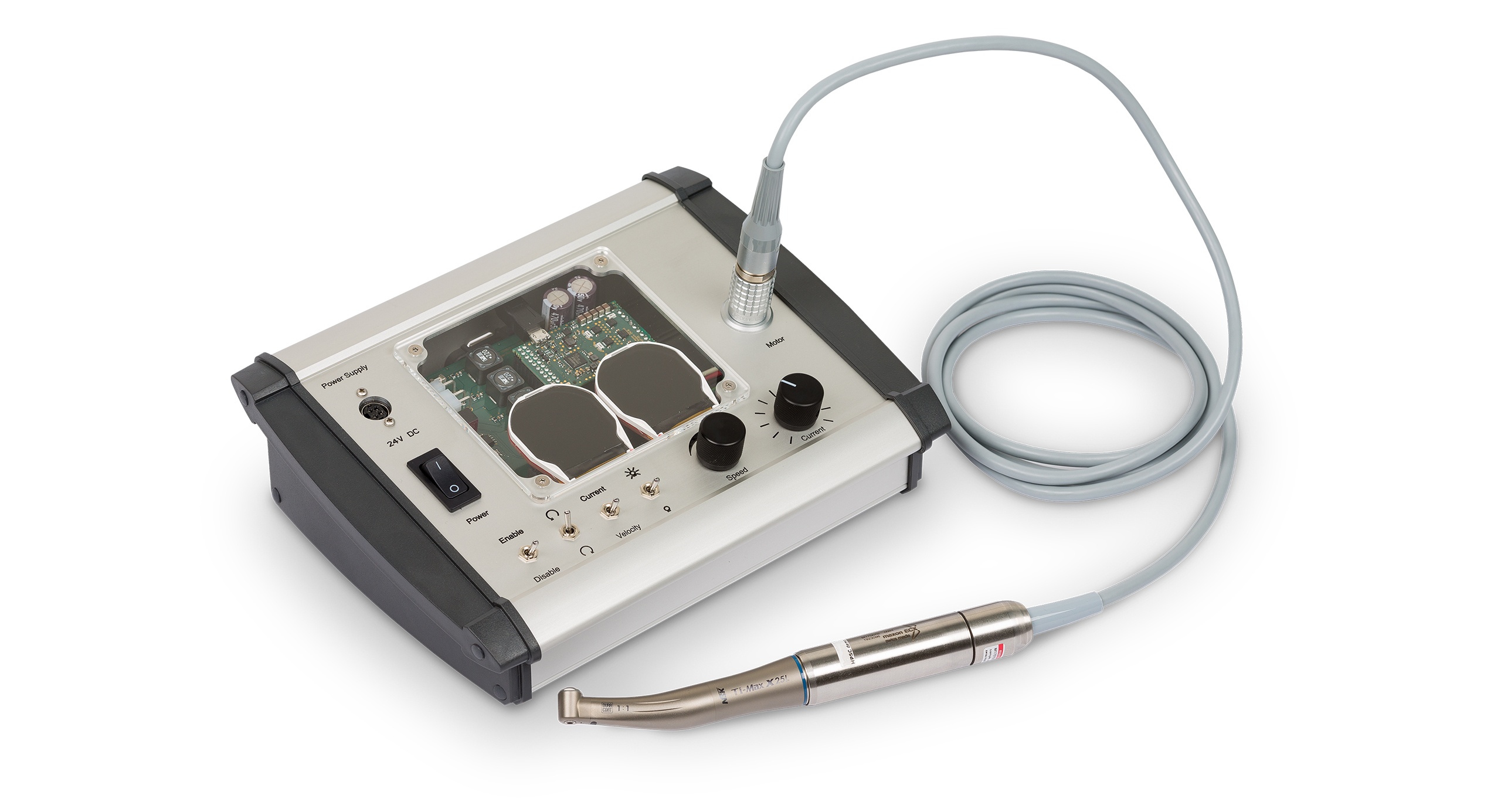

This is a HPSC control module from maxon motor. Sensorless speed and torque control allow field-oriented control (FOC) of brushless motors. Such control is from full stop to full speed under load … a sophisticated signal-injection algorithm determines the rotor position for smooth starts.
