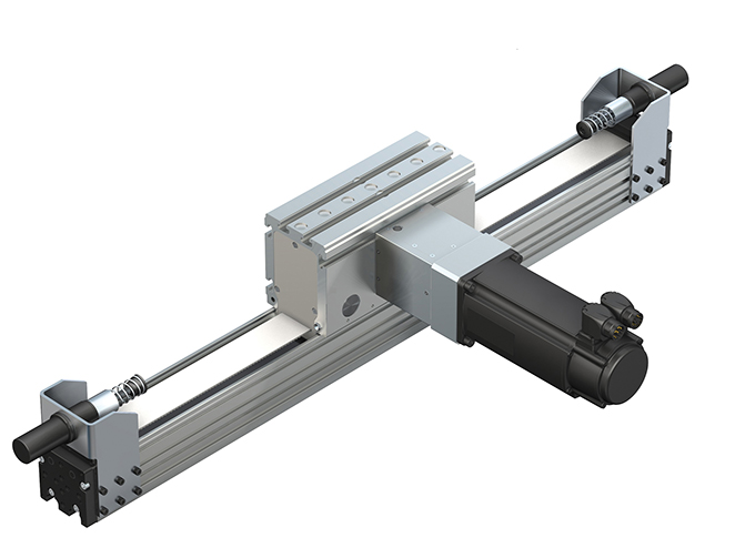

Linear modules must endure high speeds and loads in automation, handling, and pick-and-place operations, so safety dampers can be used to provide reliable insurance against impact damage. This long-stroke Omega module from Bosch Rexroth uses safety dampers from ACE Controls in its end positions. ACE’s SCS33 to SCS64 safety dampers true linear deceleration while protecting the Z-axis against uncontrolled motion. ACE safety dampers are specifically designed for emergency use only and offer reliable protection at an affordable cost.

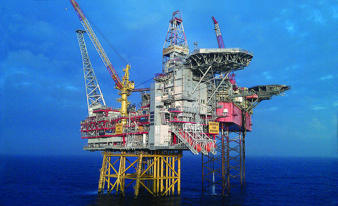

With a shock and vibration isolation system that includes highly tuned dampers from ITT’s Control Technologies, this design absorbs impact energy several times greater than past designs.

Isolation system manages cargo kinetic energy
Norwegian oil company Statoil’s Gudrun Platform operates in the North Sea’s Gudrun field. The platform operates cranes for around-the-clock cargo handling. As crane operators hoist supplies from ships to the platform, containers (some weighing as much as 8,000 kg) can move toward the Gudron Platform at 3 m/sec.
“Moving equipment from a supply ship onto an offshore platform in difficult conditions requires a highly engineered system of shocks and dampers,” said Tomm Kuran, sales manager for pneumatics at Servi Hydranor AS, a Norwegian distributor of hydraulic and hydraulic-related products. “The Gudrun’s crane operators move food and heavy, expensive equipment for drilling. If an operator mishandles a container, people can be hurt or equipment destroyed.”
“A mishandled container can also halt drilling operations,” said Peter Bauer, managing director for ITT Control Technologies EMEA. Flexible barriers have been used for approximately 10 years on offshore platforms in the North Sea, but they often sustain damage from containers slamming into them.
Engineers came to Servi Hydranor and ITT’s Control Technologies early in the design process of the Gudron Platform with a set of specifications (including environmental conditions) and space limitations. While offshore rig builders know how to stabilize cranes, engineers saw challenges in designing a dampening system for its cargo barrier.
Gudrun installation
So, the two companies engineered a shock and vibration isolation system that includes highly tuned dampers that absorb the cargo’s kinetic energy. Because of the design, the barrier system handles impact energy several times higher than traditional designs. The companies completed the shock and isolation design work in 2013, and the Gudrun Platform is now in operation.
