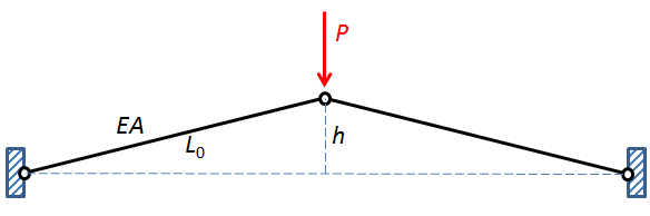

A: In a typical structure, an increase in force causes an increase in displacement. Negative-stiffness mechanisms are those that can, during some region of their force-displacement relationship, exhibit increasing displacement with decreasing force.
An example of a negative-stiffness mechanism is a two-bar structure under compression, as shown below.

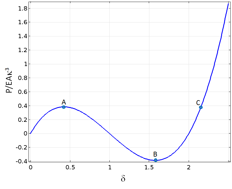

Force (P/EAκ3) versus Displacement (δ) of a two-bar structure under compression.
Images credit: Comsol Inc.
Notice that between points A and B, displacement is increasing while force is decreasing. Thus, the structure’s stiffness is negative in that region.
