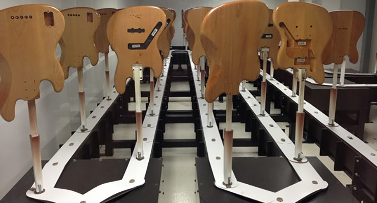

Spindles attached to the chain allow products to rotate as they’re conveyed. Image credit: BGK Finishing Systems
A chain-on-edge (COE) conveyor is essentially a single-strand chain conveyor that has been turned 90 degrees, so that it runs on its side. The chain-on-edge design typically uses a roller chain that runs in a channel and is supported by plates. The chain flexes along the horizontal axis, allowing this style of conveyor to make horizontal turns. Vertical curves (height changes) are also possible with the chain-on-edge design, but the curves must be gradual. These turning capabilities make chain-on-edge conveyors much more versatile than traditional chain conveyors.
The key to product rotation in a chain-on-edge conveyor is the use of spindles attached to the chain. The spindles can be designed to rotate freely, to rotate and stop at preset positions (90 and 180 degrees, for example), or to stop at custom positions. Stationary spindles are also an option, and are often used for smaller parts that need to be transported with access to all sides, but not necessarily rotated, during transport.

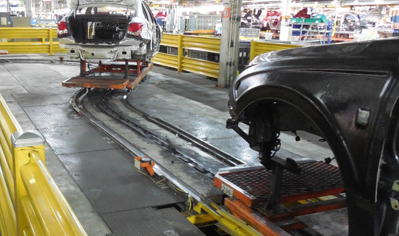

Although their unique feature is the ability to rotate parts during transport, chain-on-edge conveyors are also used for transporting heavy loads that don’t rotate, but that require full access to the outer sides and top of the part. In these applications, the load is carried on a truck, or cart, attached to the chain. For large or asymmetrical loads, the chain is accompanied by external tracks, or outriggers, that help support and guide the load.
A chain-on-edge conveyor with outrigger tracks to help support and guide the load. Image credit: Central Conveyor

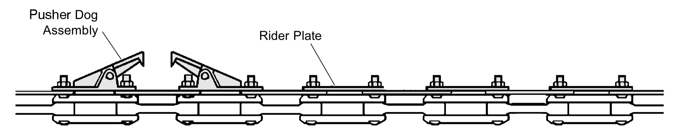

Rider plates attach to the chain, and pusher dogs — mechanical latch-type devices that engage and disengage with the trucks — attach to the rider plates. In some chain-on-edge designs, pusher dogs can be used to facilitate product accumulation or transfer from one chain to another.
Mechanical latches called pusher dogs engage and disengage with transport trucks and can allow products to accumulate or transfer from one chain to another. Image credit: Jervis B. Webb Co.
