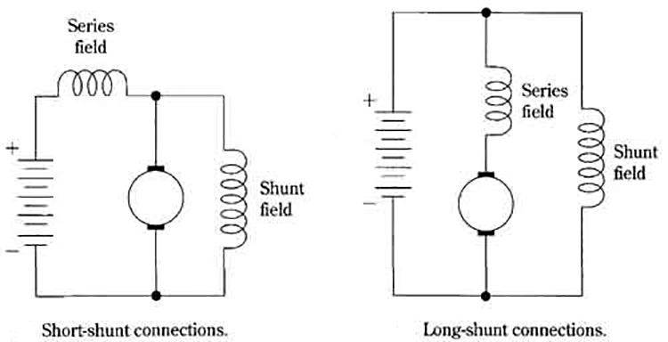

Compound wound DC motors
A hybrid between the series wound and shunt wound designs, a compound wound DC motor has a field winding that is connected in series with the armature winding and another field winding connected in parallel (shunt) with the armature winding. There are several sub-types of compound wound DC motors, depending on whether the shunt field winding is connected only across the armature winding (referred to as a “short shunt” design), or whether the shunt field winding is connected across the series combination of the armature and the field winding (referred to as a “long shunt” design).
wound field motors
Compound wound DC motors can be short shunt design, with the shunt field connected across only the armature, or long shunt design, with the shunt field connected across both the armature and the field windings.
In the short shunt design, if the polarity of the shunt field matches the polarity of the series field and the armature, it is referred to as a cumulative compound motor and has the combined characteristics of series wound and shunt wound motors: high starting torque and good speed regulation. Conversely, if the polarity of the shunt field is opposite that of the series field and armature, it is referred to as a differential compound motor.
Cumulative compound motors are used in a wide variety of applications, from conveyors to heavy equipment such as ball mills. Differential compound wound motors have few practical applications, since they tend to overspeed when the load is reduced and to drop speed significantly when the load is increased.
