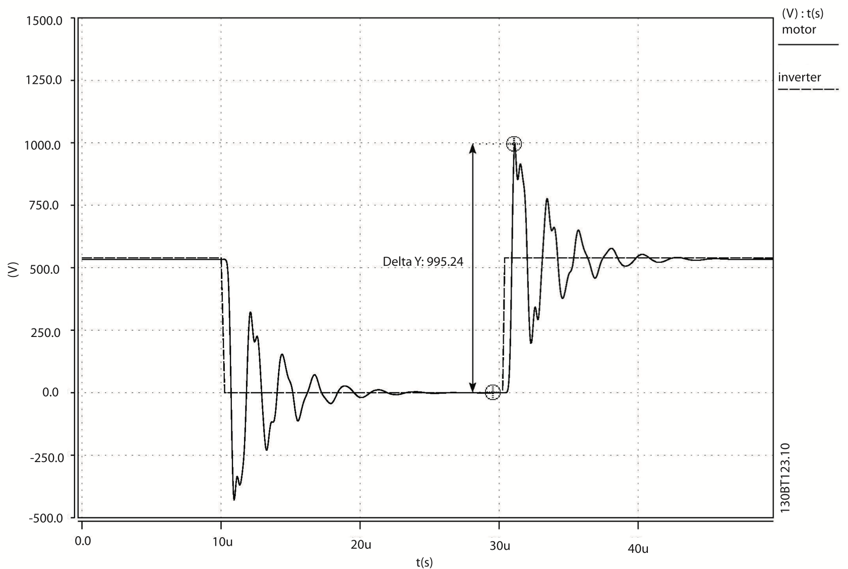

Further, the inductance and capacitance (recall in AC circuits, inductance and capacitance are components of impedance) of each component — the drive, cable, and motor — can form a resonant circuit that causes the edges of the voltage pulses to take on an underdamped sinusoidal waveform. This is sometimes referred to as cable ringing, and it can cause voltage peaks that are much greater than twice DC bus voltage — enough to damage the motor and the cable.
cable ringing
Shown here is a comparison of voltage at the motor terminals (solid line) to that at the VFD output (dashed line) for a cable length of 200 m.
Image credit: Danfoss
Note that motor impedance increases as motor size decreases. Therefore, smaller motors have a higher impedance and are more susceptible than larger motors to cable ringing for a given cable length, due to a greater mismatch between motor and cable impedances.
