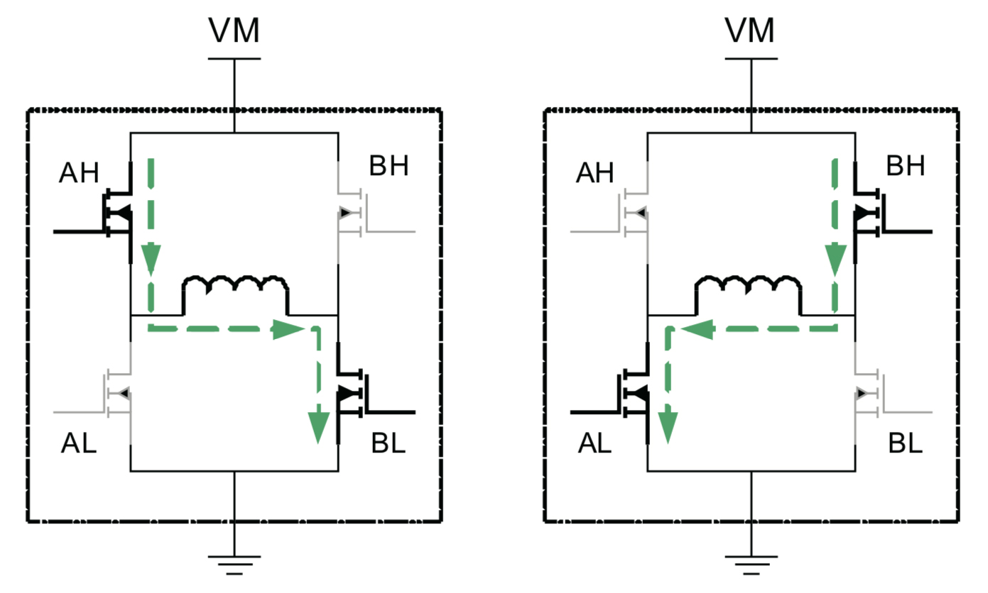

In an H-bridge, diagonal switches are turned on to allow current to flow through. Alternating the sides of the “on” switches changes the motor’s direction of rotation.
Image credit: Texas Instruments
Turning on two FETs on the same side of the H-bridge causes very high current (referred to as “shoot through”) that could damage the FETs. Therefore, when the FETs on one side of the H-bridge need to be turned on sequentially, a method referred to as “break before make” is used.
This method disables the first FET for a set amount of time (typically a few hundred nanoseconds) before the second one is enabled, preventing shoot-through. During this brief “dead time,” when neither FET is enabled, internal body diodes on the FETs carry the current.
