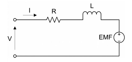

DC motor
Typical DC motor circuit

According to Kirchhoff’s Voltage Law, the applied voltage is given as:

R = motor resistance (ohms)
Substituting for VE (from above)
motor constant
Now, multiplying voltage by current, we get:
motor constant
