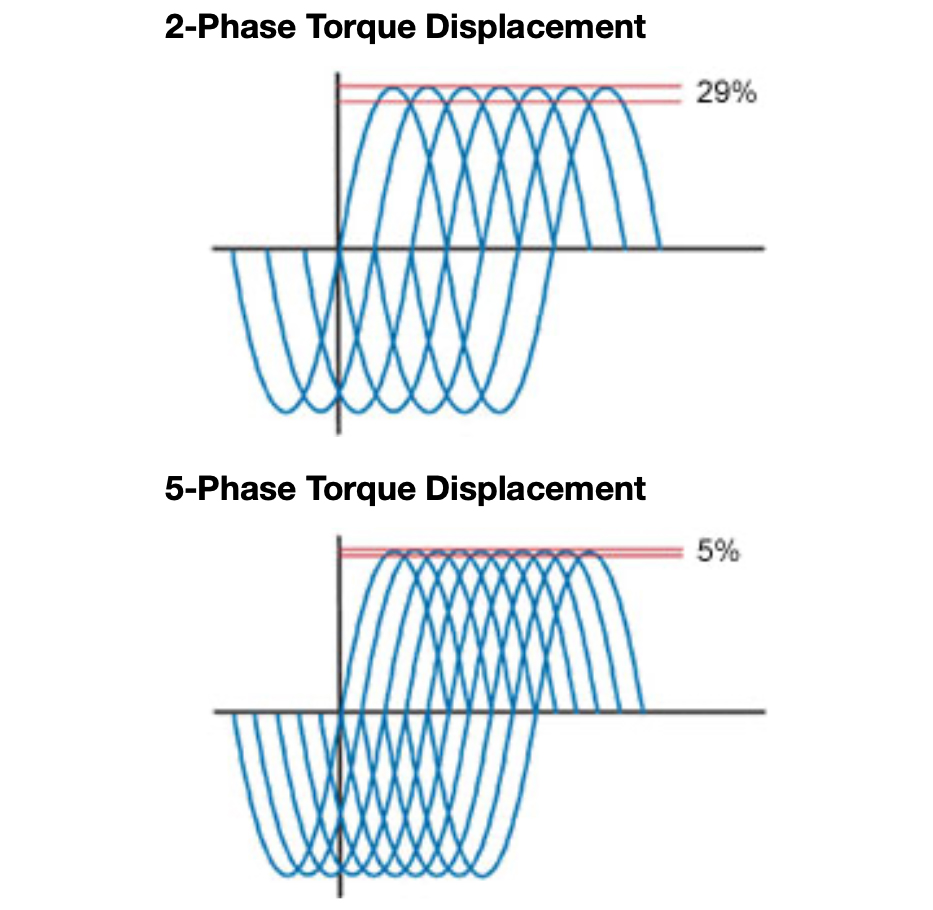

Five-phase stepper motors also have smaller step angles than typical 2-phase motors. As with microstepping, the smaller step angle means less current is required for each step, so any vibrations that occur are less severe. And with more phases (five versus two) contributing to output torque, the motor experiences lower torque ripple, and in turn, fewer vibrations.
torque displacement 5-phase vs 2-phase
5-phase stepper motors experience much lower torque ripple – and, in turn, lower vibrations – than 2-phase designs.
Image credit: Oriental Motor
