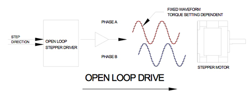

Stepper motors have 50 to 100 poles and are two-phase devices. In contrast, servo motors have between four and 12 poles and are three-phase devices.
Stepper motor drives generate sine waves with a frequency that changes with speed, but with an amplitude that is constant.
Open-loop Stepper Diagram
Image credit: QuickSilver Controls, Inc.

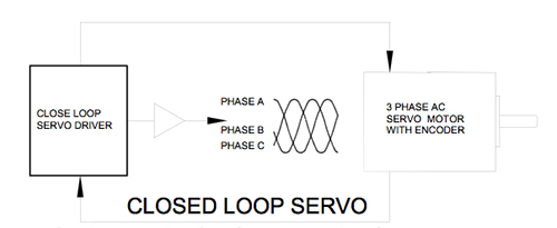

Servo drives, on the other hand, produce sine waves with variable frequency and amplitude — allowing them to control both speed and torque.
Closed-loop Servo Diagram
