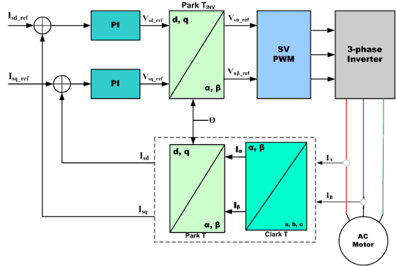

What is vector control?
The basic premise of vector control, also referred to as field oriented control (FOC), is to transform a three-phase system that is dependent on time and speed into a two-coordinate (d and q), time invariant system. It does this mathematically through the use of a Clarke transform and a Park transform.
AC motors have only stator windings (the current in the rotor is induced electromagnetically, hence the term induction motor) but there are two components to the stator current: the magnetizing current (d) and the torque-producing current (q). The magnetizing current lags the voltage by 90 degrees, and the torque-producing current is in phase with the voltage. Recognizing this relationship, a vector drive is able to control the two currents independently, much like the operation of a DC motor. Decoupling the torque and magnetizing currents allows independent torque control.
Vector Control
A basic scheme for vector control of AC motors.
Image credit: Renesas
