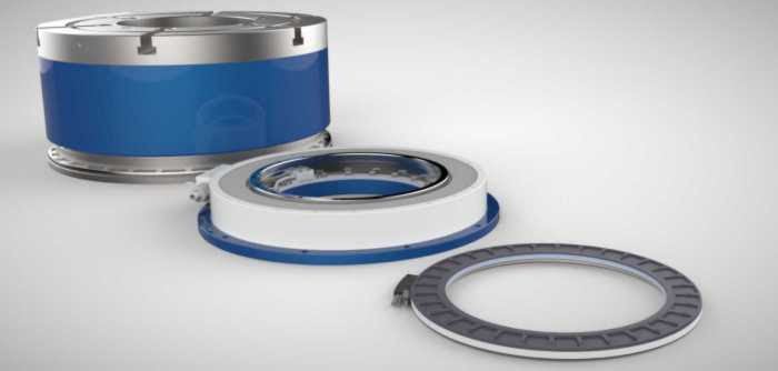

This rotary actuator from IntelLiDrives includes a servo torque motor, crossed roller bearing support, and integrated encoder.

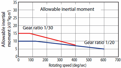

Rotary actuator sizing generally begins with determining the load inertia — a function of the load’s mass, geometry, and any gear reduction applied between the motor and actuator. The load inertia must be within the selected actuator’s “allowable load inertia” — a parameter included in the technical specifications of most rotary actuators — otherwise, the motor may not be able to effectively move and control the load. This is especially important for highly dynamic applications that involve quick acceleration and deceleration rates or frequent changes in rotational direction.
rotary actuator sizing
Allowable load inertia and speed are often plotted on an inertia-speed chart.

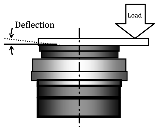

Some rotary actuator manufacturers also include specifications for moment stiffness and torsional stiffness. Moment stiffness — typically given in units Nm/rad — indicates the output flange’s ability to resist tilting when a load is applied at some radial distance from the center of the actuator.

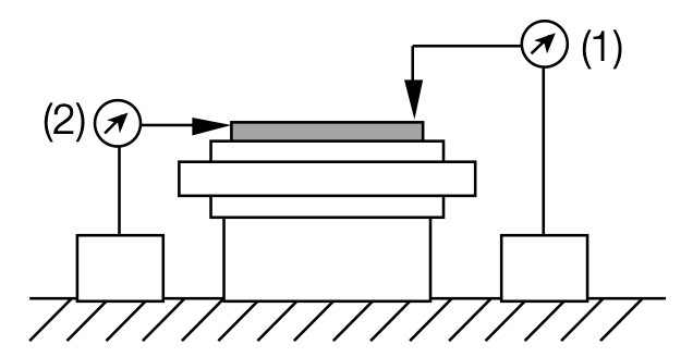

Along with the common specifications of positioning accuracy and repeatability, the positioning capabilities of rotary actuators are also defined by the axial and radial runout values of the output table, or flange, which are determined by the parallelism and concentricity of the output table to the base. (Runout indicates how much one surface or feature varies with respect to a datum when the actuator is rotated 360° around the datum axis.) Axial and radial runout determine how much the output flange “wobbles” — that is, how much a point on its surface varies in the vertical and horizontal directions — as it rotates.
Axial runout (1) and radial runout (2) are determined by the parallelism and concentricity between the output flange and the base.
