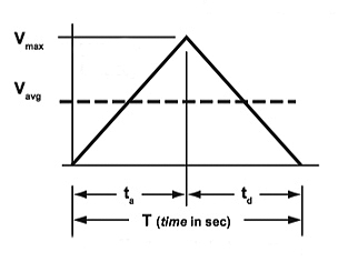

Triangular motion profiles: For quick, point-to-point movements
A triangular motion profile is characterized by equal acceleration and deceleration times (and distances), with no time spent at a constant velocity. In other words, a triangular motion profile divides the time allowed for the move into two halves — an acceleration period and a deceleration period.
This profile is commonly used for applications that don’t require a period of constant velocity — such as transport and pick-and-place — since it provides the fastest movement between two points.
Calculations of velocity and acceleration for a triangular motion profile are based on the geometry of a triangle, making them relatively simple. The height of the triangle represents the maximum velocity, and acceleration is found by dividing the maximum velocity by the time to accelerate, which is ½ of the total move time.
motion profile
For a standard triangular move profile, where ½ of the time is used for acceleration and ½ for deceleration:

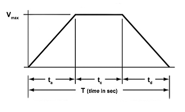

Trapezoidal motion profiles: For steady, constant-velocity movements
Unlike a triangular move, a trapezoidal motion profile allows a specified time (or distance) to be spent at a constant velocity. The mathematically simplest version of the trapezoidal profile breaks the total move time into thirds, allowing 1/3 of the total move time for acceleration, 1/3 for constant (maximum) velocity, and 1/3 for deceleration. But it is quite common for trapezoidal moves to use a longer portion of the time for constant velocity, with very quick acceleration and deceleration rates.
The trapezoidal motion profile is arguably the most common in motion control applications, since it forms the basis of processes that require a period of constant velocity, such as dispensing, measuring, and machining.
The motion calculations for trapezoidal move profiles are a bit more complex than for triangular moves. The best way to analyze a trapezoidal motion profile is to break the profile into two right triangles (for the acceleration and deceleration phases of the move) and a rectangle (for the constant velocity phase).
motion profileFor a standard trapezoidal move profile, where 1/3 of the total time is used for acceleration, 1/3 for constant velocity, and 1/3 for deceleration:
