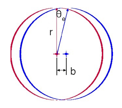

Radial runout is important because it affects the ability to center a part on the table. If radial runout is significant, a point on the surface of the part will deviate radially from its intended location and lead to unacceptable angular error, which can be calculated as follows:
angular error
radial runout
θe = angular error (arcsec)
b = runout (mm)
D = diameter of the part (mm)
1.296 x 106 = conversion from degrees to arc seconds
