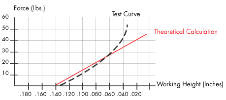

Wave springs have relatively linear spring constants and provide consistent force over a range of deflections (or conversely, predictable deflection over a range of forces).
Deflection characteristics of a typical wave spring (theoretical vs. measured).
Image credit: Smalley
The behavior of a spring is often depicted in a force-deflection chart, which shows the amount of deflection the spring experiences for a range of forces. The slope of the force-deflection curve represents the spring constant, and the area under the curve is equal to the work done by the load to displace the spring. This work — force applied over a distance — represents the potential energy (strain energy) stored in the spring. (See note below for more on the work-energy relationship.)
