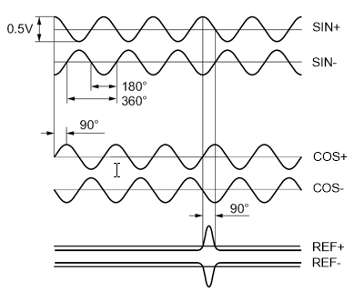

To mitigate the effects of noise, sine encoders can use a technique referred to as differential signaling, in which two complementary signals are transmitted on each channel. This technique is also used to mitigate noise in incremental encoders, although the analog signals of sine encoders are more susceptible to noise than the digital signals of incremental versions.
The analog signals produced by sine encoders are sensitive to noise, but complementary signals (Sin-, Cos-, and Ref-) can provide some immunity to common mode noise.
Image credit: Ingenia
These complementary signals — often termed “A-,” B-,” and “R-” — are the same as the primary signals, but with a 180 degree phase shift. Because any noise on the signals is the same (referred to as “common mode” noise), taking the difference of the two signals eliminates the noise but preserves the signal waveform.

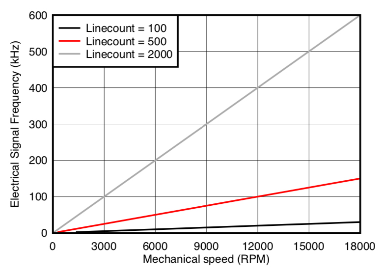

One limitation in the application of sine encoders is the frequency of the encoder output versus the bandwidth that the receiving electronics can process. The output frequency is determined by the encoder’s line count and mechanical speed, and when a sine encoder with a very high line count is operated at high speed, the output frequency of the encoder may exceed the bandwidth that the drive or controller can process.
sine encoder
If an encoder with a high line count is operated at high speed, its frequency could exceed the bandwidth of the receiving electronics.
