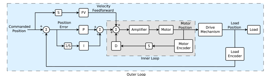

There are several methods of operation with dual-loop control, but in the most basic method, the controller first closes the inner loop, which is the velocity control loop. The velocity control loop receives feedback from motor encoder, and this feedback determines the appropriate velocity feedback gain (Kv), which imparts a damping effect on the system to reduce oscillations.
Note that velocity feedback gain (Kv) is similar to derivative gain (Kd), except that velocity feedback scales only the velocity measured by the motor encoder, whereas derivative gain scales the derivative of the position error. Velocity feedback gain is often used in dual-loop control.
Next, the controller closes the outer loop, which is the position loop. Feedback from the load encoder is used to determine the appropriate proportional and integral gains (Kp and Ki). Recall that proportional gain is directly proportional to the positioning error and influences the system’s stiffness, while integral gain accumulates the position error over time and “pushes” the system to zero positioning error.
dual-loop control
A typical dual-loop control scheme. Notice that this control method also uses velocity feed-forward commands to compensate for phase lag between the inner (velocity) and outer (position) loops.
Image credit: Galil
The servo control system may also include a current control loop, positioned inside the velocity loop. Although in this scenario there would be three control loops, the term “dual-loop control” simply refers to the two control loops — position and velocity — that receive direct feedback from the encoders.
Unlike traditional cascaded control loops, in dual-loop control, the velocity loop response is independent of the feedback (and, therefore, the resolution) of the load encoder. Likewise, the position loop response is independent of the feedback from the motor encoder.
