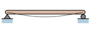

Mechanical stiffness
Systems that are mechanically stiff resist deformation when subjected to loads. In other words, they can withstand high forces or bending moments without a change in their shape or position. (Note that the opposite of mechanical stiffness is compliance.) The mechanical stiffness of a part depends on both its modulus of elasticity and its planar moment of inertia, which is determined by the size and shape of the object.
servo stiffness
The mechanical stiffness of a structure depends on its size, shape, and material.
Image credit: wikipedia.org
In motion systems — such as automation or assembly equipment — the most significant influences on mechanical stiffness come from connection points between the motor and the load, including gearboxes, drive mechanisms (belt and pulley, screw, etc.), and couplings. This is one of the reasons direct drives (linear motors and torque motors) exhibit high stiffness — because the load is coupled directly to the motor, eliminating any intermediate power transmission components.
In theory, a motion system cannot be too stiff mechanically. A system with low compliance and high stiffness transmits power more efficiently and with better responsiveness than a system with low stiffness. But in real-world applications, mechanical stiffness must be balanced with damping elements to avoid transmitting shock loads and vibrations throughout the system.
