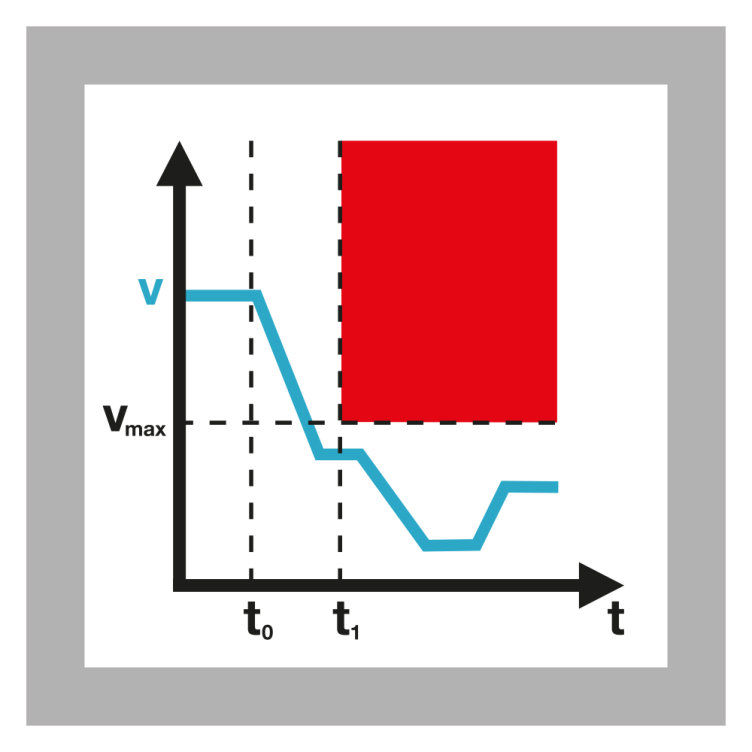

Safely Limited Speed (SLS) — This function ensures that a maximum, predefined speed is not exceeded. When SLS is initiated, the motor undergoes a controlled deceleration to a speed equal to or below the specified maximum. Then, if the maximum speed is exceeded, power to the drive is switched off, typically by using the Safe Torque Off (STO) or Safe Stop 1 (SS1) function.
safely limited speed
The SLS function monitors the maximum speed of the motor.

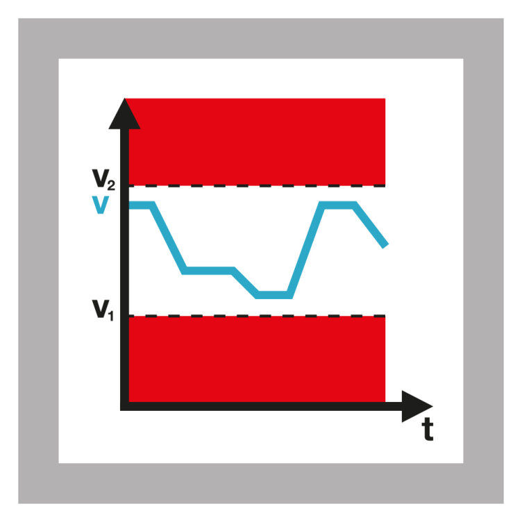

Safe Speed Range (SSR) — This function ensures the motor’s speed does not fall below a predefined minimum or exceed a predefined maximum. If the motor speed falls outside of the specified range, power to the drive is switched off.
safe speed range
The SSR function monitors the maximum and minimum speed of the motor.
