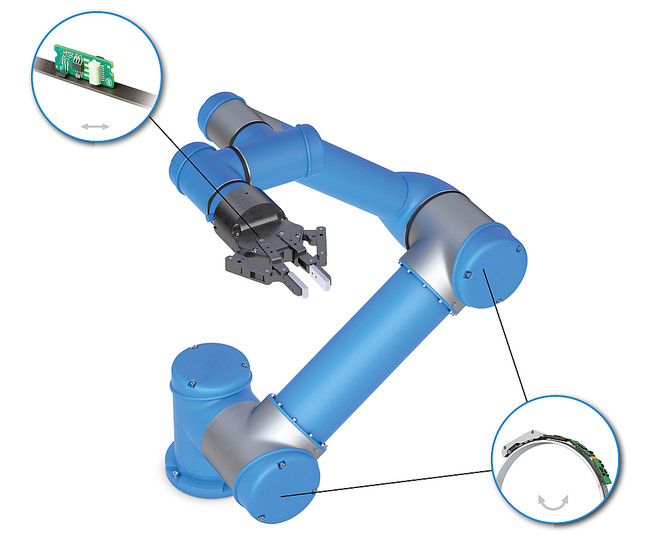

ring encoder
One of the fastest growing application areas for ring encoders is in robotic arms – whether traditional SCARA or 6-axis types or cobot designs based on these technologies. Here, ring encoders are used on the robot joints while a linear encoder is used on the end-of-arm gripper.
Image credit: SIKO
Radial and axial ring encoders are often used in space-constrained applications — especially those that use rotary direct-drive motors — such as robot joints and rotary indexing tables and actuators. The ring encoder’s small axial height minimizes footprint, while the large bore provides a pathway for routing cables and pneumatic lines.
