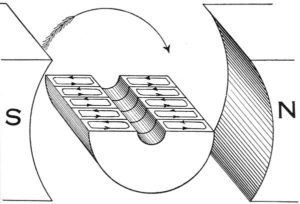

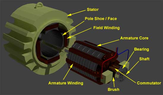

DC motors are constructed with two major parts: the rotor and the stator. The rotor has a ring-shaped iron core with slots that hold coils, or windings. Following Farady’s law, when the core is rotated in a magnetic field, a voltage, or EMF, is induced in the coils. This induced EMF causes current to flow, known as eddy current.
laminations
Eddy currents are the result of the armature core rotating in a magnetic field.
Image credit: electrical4u.com
Eddy currents are a form of magnetic loss, and the power loss due to the flow of eddy currents is referred to as eddy current loss. (Hysteresis loss is another component of magnetic loss.) These losses produce heat and reduce motor efficiency.
