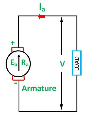

To see why DC motors experience high startup current, we can examine the voltage equation of a DC motor:
motor starters
Image credit: circuitglobe.com
motor starters
Where:
E = supply voltage
Eb = back EMF
Ia = armature current
Ra = armature resistance
Back EMF is directly proportional to the motor’s speed, so at startup, when motor speed is zero, back EMF is also zero. Therefore, removing the Eb term and rearranging the voltage equation, we can see that, at startup, armature current is inversely proportional to armature resistance.
motor starters
For the best motor performance, armature resistance in DC motors is kept very low (typically less than 1 ohm). To see how significantly this affects the starting current, we can assume that armature resistance (Ra) is 0.4 ohm and supply voltage (E) is 220 V. This gives a starting current (Ia) of 550 amps, which can be more than ten times the rated current, and high enough to damage the internal motor circuit.
