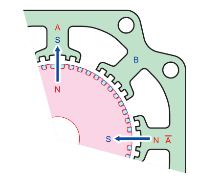

Hybrid stepper motors are constructed with a rotor made of two sections, or cups, with a permanent magnet between them. This causes the cups to be magnetized axially — with one cup polarized north and the other cup polarized south. The surfaces of the rotor cups have precisely-ground teeth (typically 50 or 100 teeth per cup), and the cups are aligned with an offset of  ½ tooth pitch between the two sets of teeth.
In a hybrid stepper motor, the stator poles are also toothed, and when pulses are delivered to the stator by the stepper drive, these poles are magnetized, causing the rotor to turn so that the teeth of the rotor and stator align (N-S or S-N).
This hybrid design — with teeth on both the rotor and stator — allows the motor to optimize magnetic flux, and therefore, produce higher torque than permanent magnet or variable reluctance designs. Hybrid stepper motors can also achieve step angles as small as 0.72 degrees in full-step mode and operate at higher speeds than other designs.
stator motor teeth
In a hybrid stepper motor, both rotor cups have teeth (red and blue) as do the stator poles (green).
Image credit: Oriental Motor

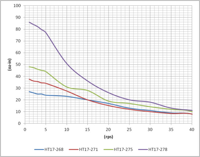

Double- and triple-stack hybrid stepper motors simply have multiple rotors and stators, stacked end-to-end. With multiple rotor and stator sections, the motor can produce more torque without the need to increase the frame size. Only the length of the motor increases. (Note that a few manufacturers also produce quad-stack stepper motors, as shown below.)
triple-stack stepper motor
Torque speed curves for a NEMA 17 stepper motor in single-, double-, triple-, and quad-stack designs. Notice that as stack length increases, so does torque. However, in the longer stack length versions, torque drops more quickly as speed increases.
Image credit: Applied Motion Products
However in double- and triple-stack (and quad-stack) stepper motor designs, torque falls off faster as speed increases than it does in single-stack designs. This is because the added rotor and stator sections also increase the motor’s inductance. And higher inductance means the electrical time constant of the motor — the amount of time it takes the current in the windings to reach 63 percent of its maximum value — is also increased. When a stepper motor operates at high speeds, a high electrical time constant means there isn’t enough time for the current (and, therefore, torque) to reach its maximum value at each motor step, resulting in a torque drop-off as speed increases.
