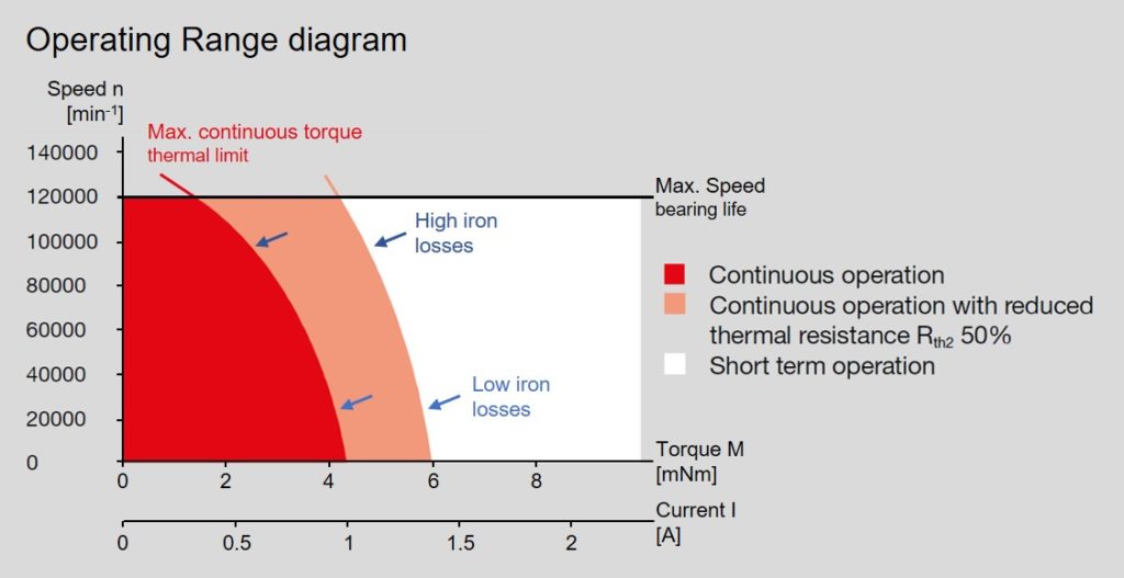

Notice that the amount of eddy current loss is proportional to the square of the frequency of magnetic reversals, and therefore, to the square of motor speed. This is why the torque produced by an electric motor decreases as speed increases — because of heating due to eddy current losses (as well as other losses, such as hysteresis losses). Motors with high pole counts, such as stepper motors, experience high eddy current losses due to their high frequency of magnetic reversals.
eddy currents
The effect of iron losses (hysteresis losses + eddy current losses) on a BLDC motor.
Image credit: maxon
Eddy current losses and hysteresis losses are categorized as core losses (also referred to as iron losses or magnetic losses) because they depend on the magnetic paths through the iron core of the motor.
